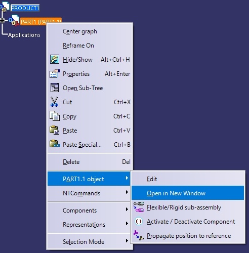

There is the command accessible through right mouse click 'Open in New Window'. Unfortunately, it is not present in the Customize/Commands/All Commands list, so I'm not able to create a shortcut icon for it.
