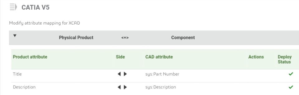

3DExperience has implemented two V5 attribute mappings by default. Both mappings seems to be not editable or changable (Please correct me if I am wrong). According to this presetting the V5 attribute "Partnumber" belongs to 3DX attribute "title".
As we and most of our customers are currently using the V5 attribute "Partnumber" to uniquely identify the component, the standard mapping is very obstructive. The "partnumbers" would appear as "titles" in 3DX. Furthermore, the component titles (e.g. "Shouldered Bush", "Housing", ...) are currently defined in the V5 attribute "Nomenclature" and will be not mapped to the intended 3DX attribute "title".
So basically I only ask if you know a way to edit the preset mappings for the V5 attributes?
