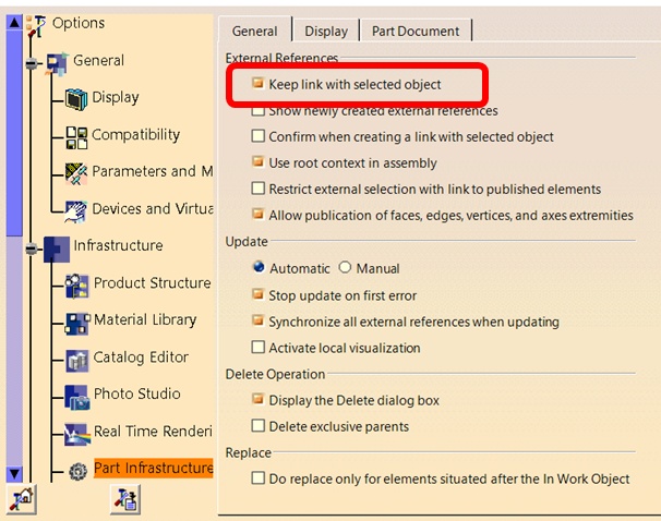

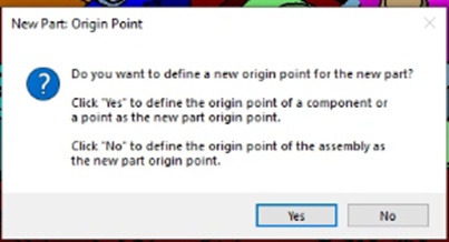

in CATIA V5, we can trigger a user question when creating a new part in the context of an assembly: the user would get asked if he wants to define a new origin point for the new part.
The option "Keep link with selected object" was controlling that option. The equivalent preference with
CATIA 3DEXPERIENCE does not do that. Does anyone know who to get that option back?
