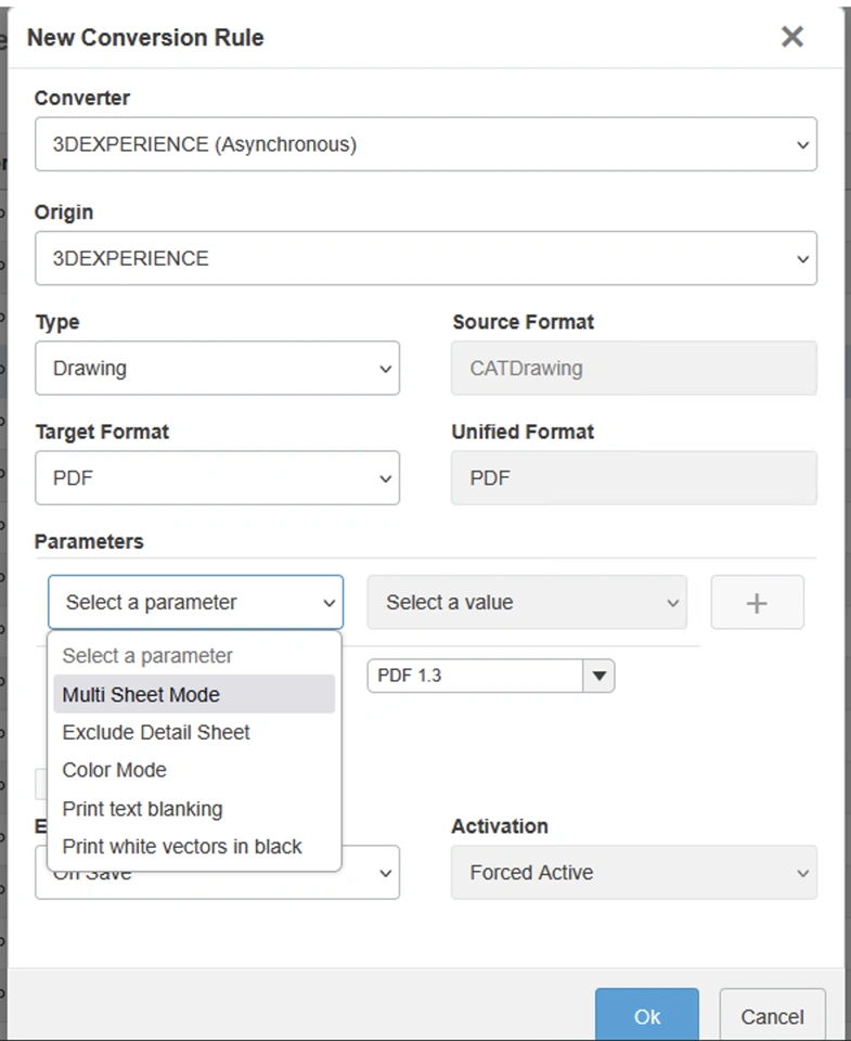

There's also a standalone tool called Derived Format Converter (installed separately from the Rich Client). Its configuration is managed via the 3DDashboard app. However, I've noticed that not all the options from PLMPrintBatch are available here.

PLMPrintBatch (Batch Utility/Batch Monitor) | Derived Format Converter (3DDashboard) PlatformManagement Dashboard->Content Tab -> Collaborative Spaces Configuration Center -> Derived Format Management(Click + on the top right of this widget) | |

| These options are missing in the Conversion rule in the 3DDashboard.

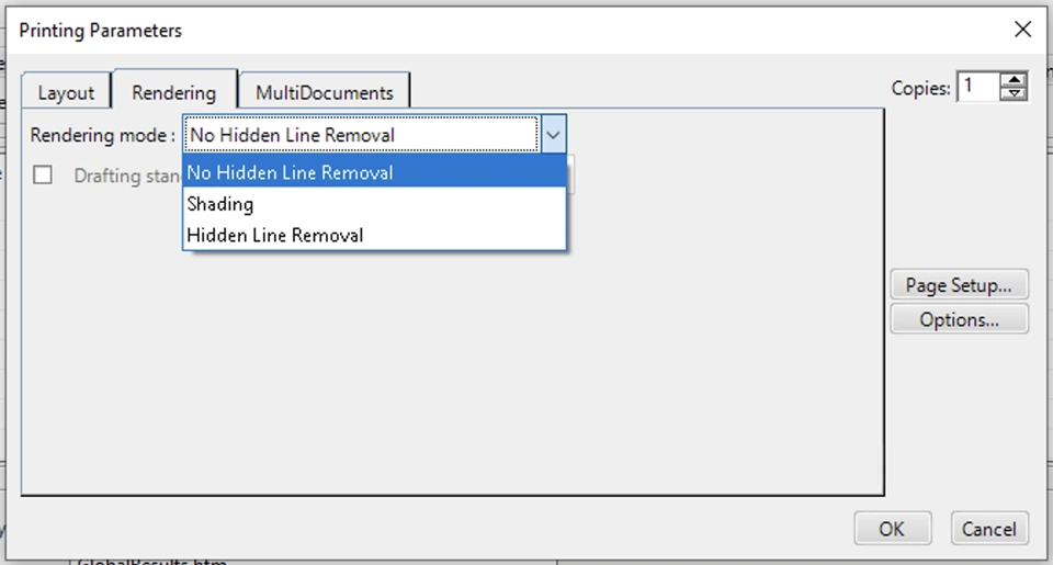

| 2 | Rendering Tab | These options are missing in the Conversion rule in the 3DDashboard.

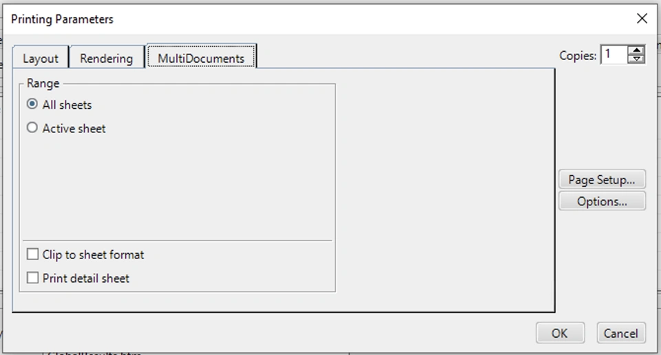

| 3 | MultiDocuments Tab | These options are partially present.

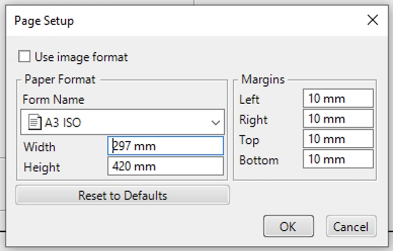

| 4 | - Paper Format: Select standard paper sizes (e.g., A3 ISO) or define custom width and height. | These options or equivalent options are missing in the Conversion rule in the 3DDashboard.

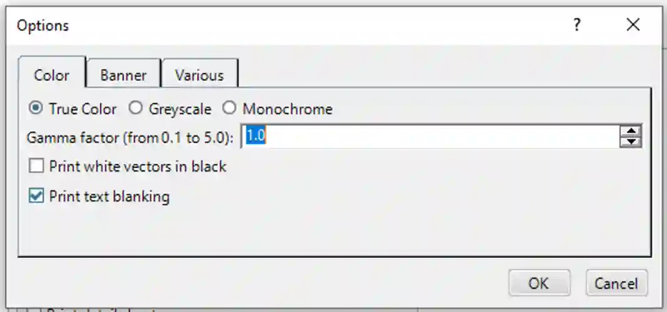

| 5 | Options Dialog
| These options are present (except for the gamma factor) in the Conversion rule in the 3DDashboard.

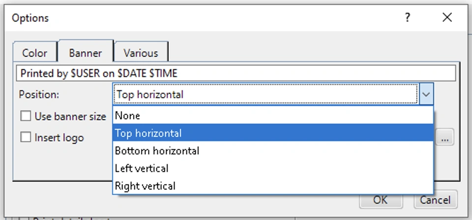

| 5.1 |
- Banner Tab: Configure banner text, position (top/bottom/left/right/none), use banner size, and insert logo.
- Various Tab: | These options are missing in the Conversion rule in the 3DDashboard.
