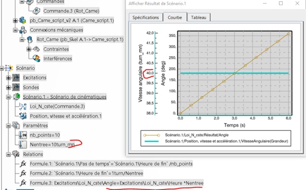

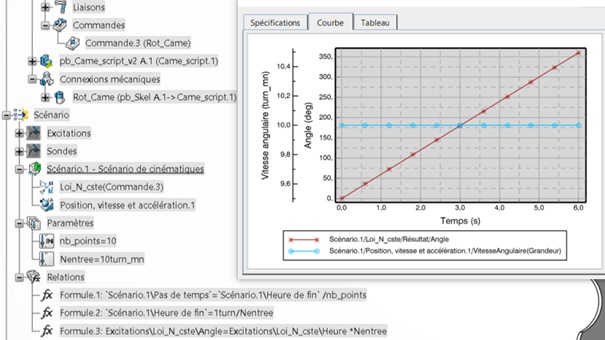

I create an excitation law to rotate at 10turn/min.
I create also a probe to measure angular speed.

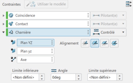

=> there is an offset of 30turn/min (whatever the speed of excitation law ... if 0 turn/mn => 30turn/mn)

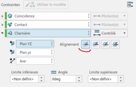

In fact it depends on angular sector selected. with the first one => no pb.
the 2 cases are on pictures.
To my mind, the angular speed is correct not the measure ....
