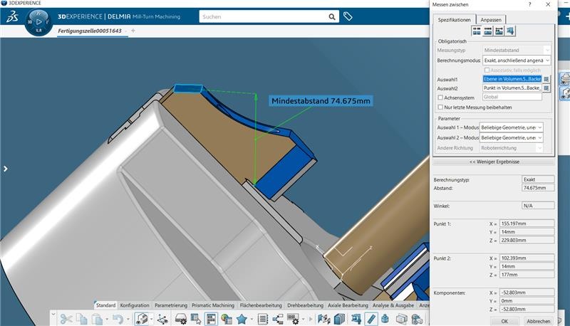

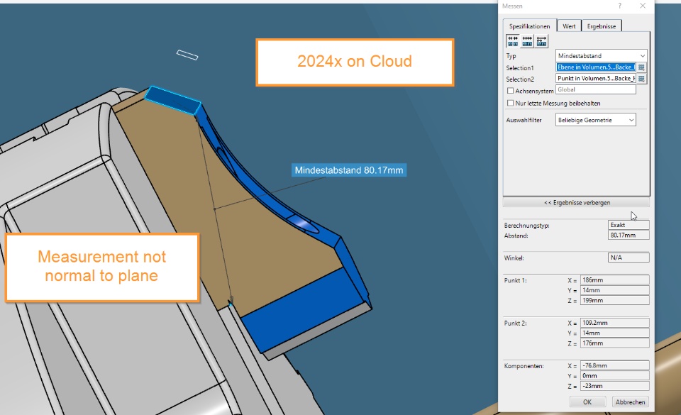

In 2024x on cloud, something seems to be different with the measuring functions.
We used to be able to measure with "any geometry". This meant that the measurement could be made normally to a plane. Now the options are missing in the measurement function.
Can someone tell me how this works or where the buttons are new.
In the pictures I show how it worked in 2022x
And how it looks now in 2024x on cloud.
