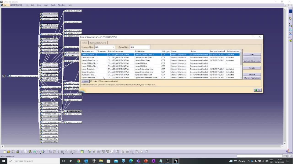

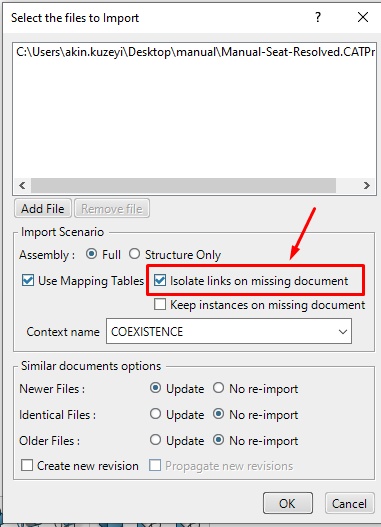

Some problems are encountered while transferring data between CATIA V5 and 3D EXPERIENCE CATIA. The data we transferred from CATIA V5 to 3D EXPERIENCE contains broken links. As you can see in the picture, there is an option to isolate the links on missing document, but this option cannot isolate all the links in the data. The method to isolate these links in Catia V5 are with the CATDUA method. As shown in the video, we need to isolate all links of the data and import the part cleanly to the platform. However, this method is a serious waste of time when we do it for multi-component parts, that is, when we isolate all the links one by one manually.
Is there an easier way to isolate these broken links found in CATIA V5 Datas? What can I do to minimize wasted time?
