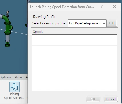

I'm trying to setup the ASD Multi-Discipline Drafting. When I want to create Piping Spool Isometric it's giving me a message that the drawing profile "ISO Pipe Setup" is missing. When clicking the Edit button my connection seems to be ok but the profile is missing.
How can I solve this?
I can't find it in the ASD Drafting Resources table
From ."..\\win_b64\\startup\\AITAC\\Batches\\piping" I imported the 3DXML files.
In the howto.txt I followed the steps. Another thing I don't understand is this: New > VPM Document to import what is mentioned with VPM?
