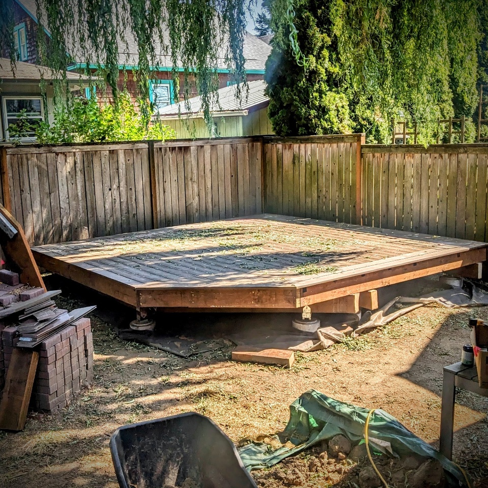

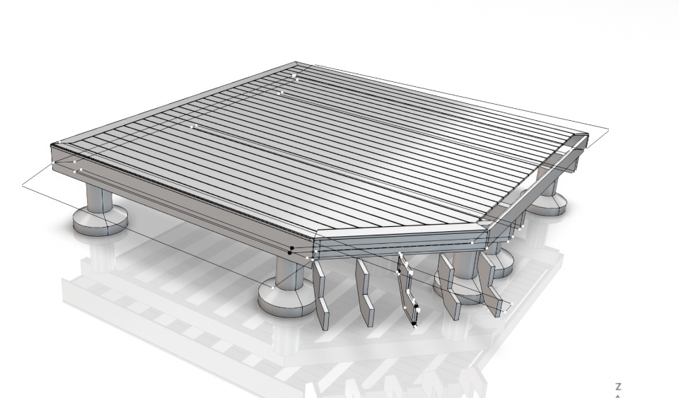

For engagement: I added pics of the deck I built in my back yard last year (with regular "part design"). There are stairs on it now, but I don't have a picture handy.
