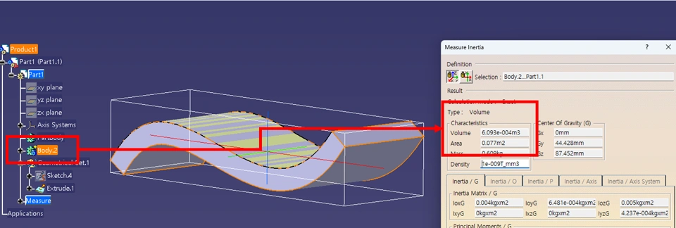

Among the inquiries from HKMC customers, they want to measure Surface Area and Volume values separately in the hybrid model with just one click.
Case 1. When you select 'Body.2', the value of Measure Inertia is displayed as Type: Volume, and the Volume value and Area are measured.

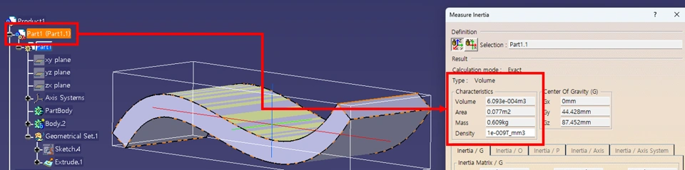

Case 3. When you select the top 'Part', the value of Measure Inertia is displayed as Type: Volume, and Volume and Area are measured. However, at this time, the Surface of the Geometrical Set.1 is excluded and measured.
In Case 3, the customer wants the Part Body value and Geometrical Set value to be measured simultaneously when the top Part is selected.
