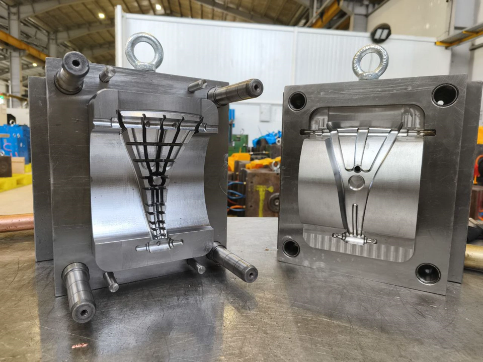

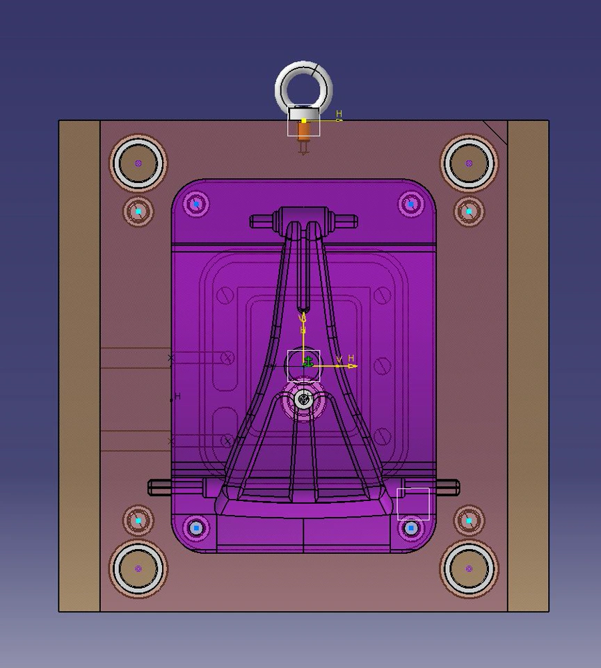

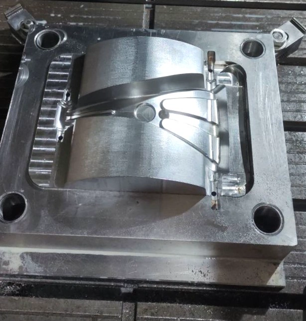

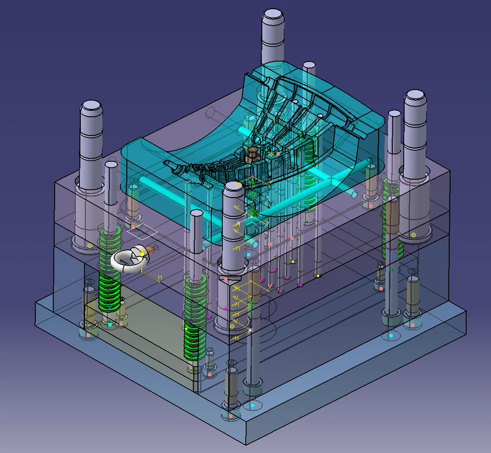

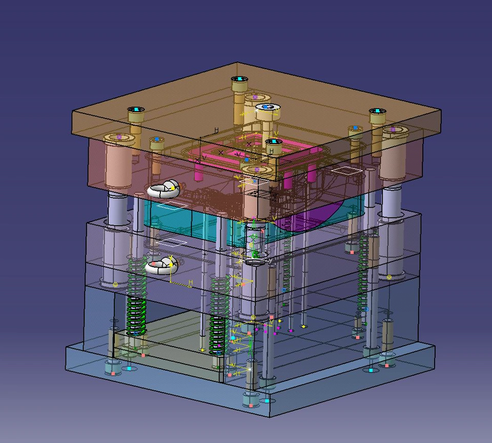

Injection Mold Design By Catia V5

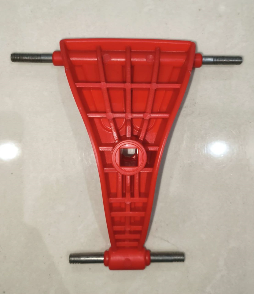

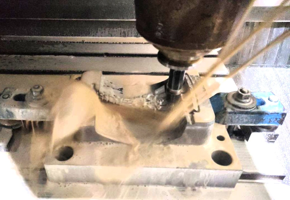

I’m excited to share one of my recent projects.

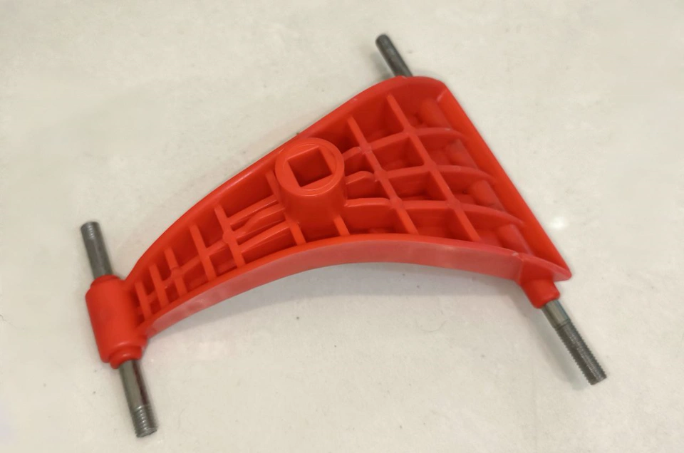

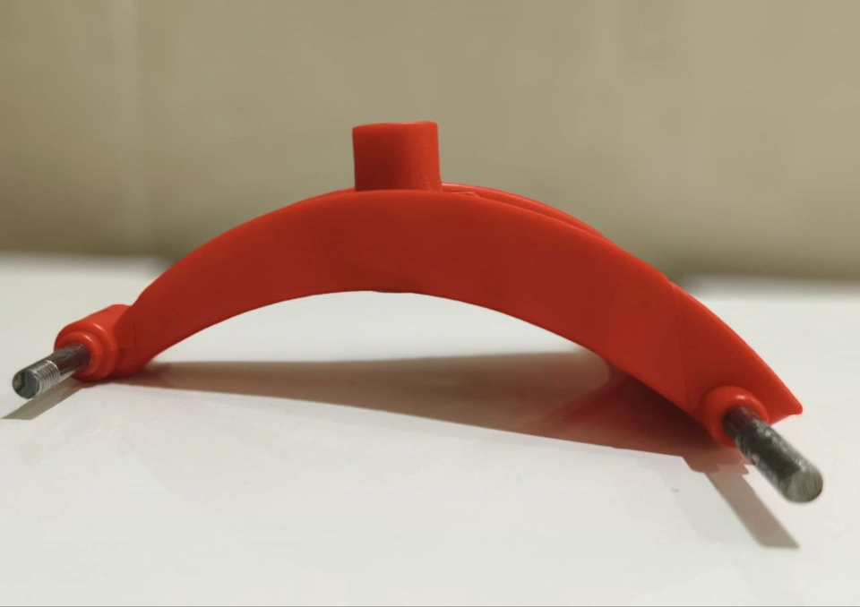

🔧 Although the mold looks simple, we did face a small challenge that required a simple solution. 💡 The issue was placing two threaded metal inserts in each cycle. To make the process smoother and more efficient, I decided to use magnets. ⚙️
Along with the mold design, I managed the project from start to finish, including manufacturing and testing at the factory.
