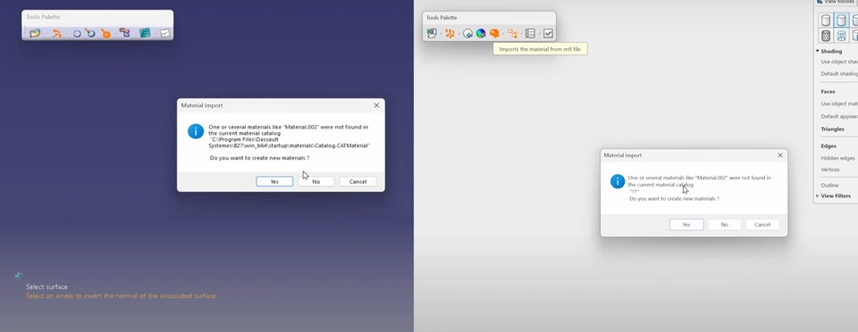

I would like to know if it's possible to import mesh files within CATIA - IMA as subdivision meshes with textures in 3D Experience CATIA.
Within CATIA V5 I have managed to transfer subdivision with colors, but for some reason for the materials - UV maps both in CATIA V5 as well as within 3D Experience it doesn't create the material.
When the model with material is loaded both CATIA and 3D Experience CATIA will load the material and will want to create a new material within the Material Catalog, still the material is not created and displayed.
Here is a video that highlights this problem
