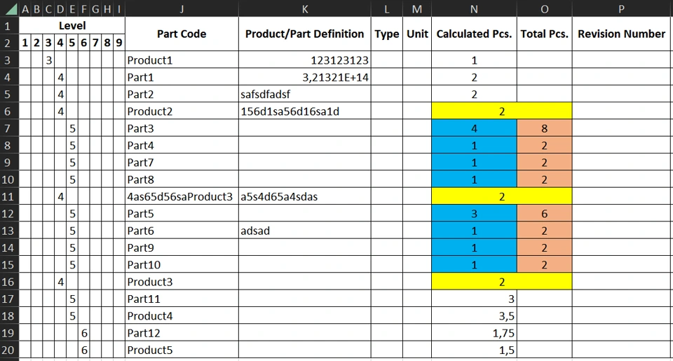

hello everyone. I'm coding a macro and I've reached an important point, but I'm getting an error. I want to ask you for help.
In the image below, the user enters the starting level manually and this process continues from the top of the product tree to the lower parts.
However, when the number of nested products increases, the output goes to wrong results. I am sharing my codes. Can you suggest me a solution? Alternatively, can anyone who has done such a study help? I'm new to this forum and have no experience yetvisual studio,visual studioAutomationvisual basic
First, I want to talk about the working system.

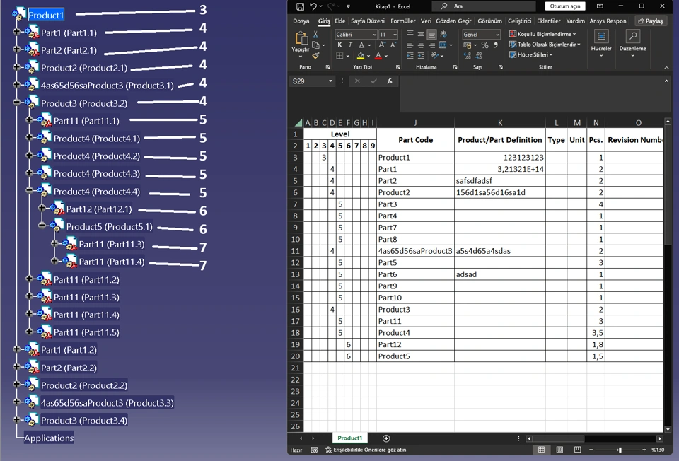

-User enters an initial value and selects standard / option (picture 1)
-Examines all parts in the active document, starting from the top product to the end.
-Then, it writes the part number and part definition sections one by one into the Excel cell in the Excel format I designed. (Picture 2)
-Then, for the counting process, I delete the repeating parts and as soon as I delete it, I give a value of +1 to a variable and write it in the pcs column.
-For levels, if the first product.count encountered is >0, I increase the level by 1 and add it to the level cells.
-Then, if the product quantity is greater than 1, I divide it by the upper value when it goes to level 9 until the next product section. You can see it in Picture 3.
