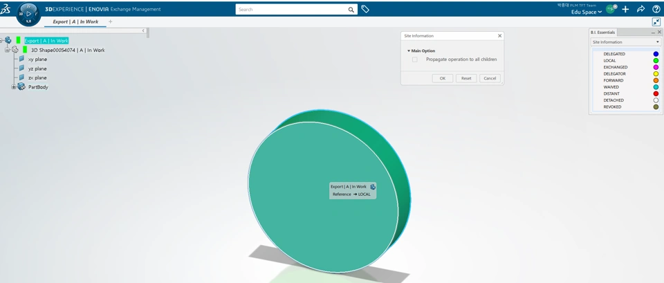

Currently, I am working on replicating data from server A to server B. Server A contains public items,(bolt, nut, etc..) and the data I am exporting consists of nine 3DXML files that form an assembly structure. During the export from server A, I use the delegate option, and upon importing to server B, I select the reference option.
After completing this process, I checked the data on server A using the Display Site Information function in the Exchange Management App. However, I noticed that the data on server A appears in a local state (green).
My ultimate goal is to ensure that the data on server A remains in an editable state, while the data on server B is stored in the same form as on server A.
