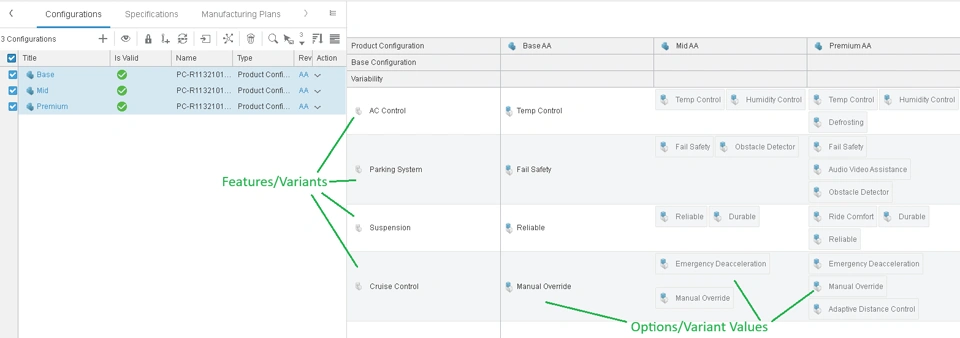

I want to design a Report which will do comparisons of different Product configurations of a Model Version. Following is my  Model having 3 Product configurations (Base, Mid, Premium) each having features and options selected as shown in below Pic.

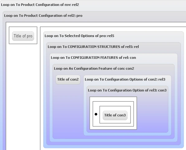

 Model Version is input Parameter to my Report template. i am able to retrieve following
  • Product Configurations of a Model Version in my case (Base, Mid, Premium)
  • For Each Product configurations selected Features in my case (AC Control, Parking System, Suspension, Cruise control)

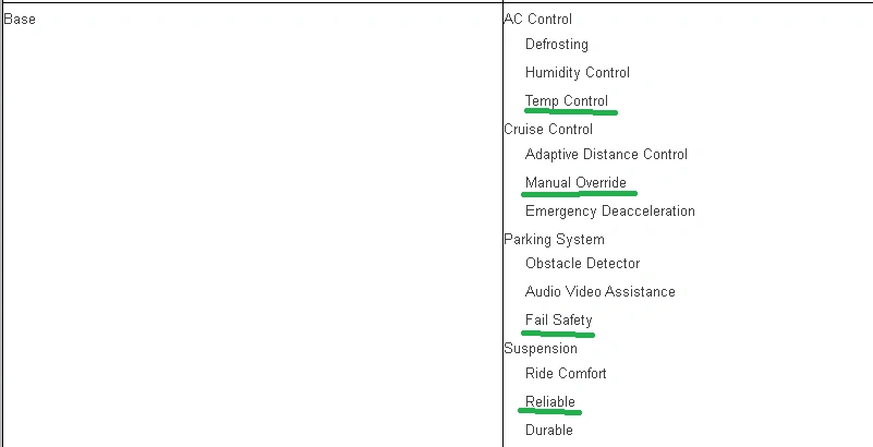

  • Problem comes at this stage as here i expected for Each Feature i need only Selected Options where as i am getting all of the Options of that Feature !
    Please find below RGD Screenshot
    Please find below Screenshot where i am getting all of the Options where as  only Green color underlined were expected.
    Can you please help in identifying issue with this template ?
