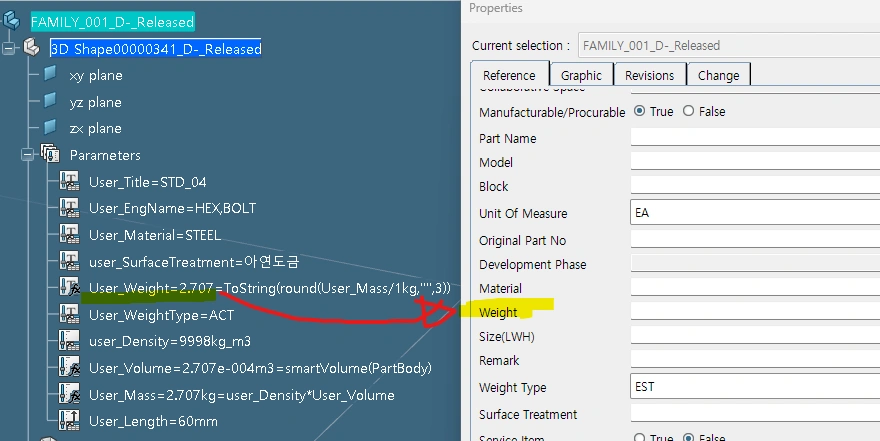

Hi everyone,
I was wondering how to map parameters and Attributes in a Component Family.
1. Situation
I modeled a standard part using Design Table, Parameter, and Relation.
A Relation is configured to automatically calculate the weight when the user adjusts the Density.
2. question
I want the User_Weight value to be automatically entered as an attribute (weight).
The value previously declared in the design table can be applied using the Valuate Attribute function,
User_Weight values that are automatically calculated by changing the design table cannot use the Set Attribute function.
In addition, we want to create and manage user attributes instead of applying materials, which is a native feature of CATIA.
