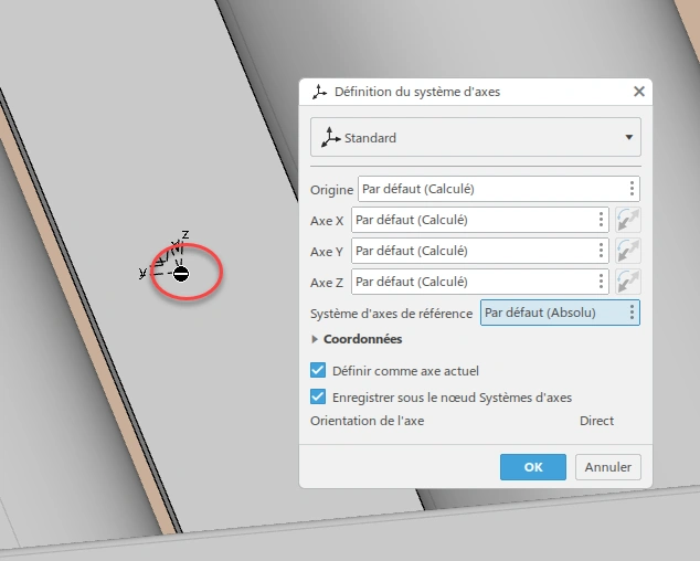

- We are preparing an assembly pattern by creating in the 3DShape of the main product, a geometrical set containing coordinate systems where we want our pattern instances to be.
- To position the coordinate systems, we select geometrical objects (point, edge, other coordinate systems...) of sub-product.
- It is easy to select them in the graphic area, since we know where we want to place our coordinate system.
Difficulty:
- Sometimes, probably for large assembly, the object is not selectable in the graphic area (no entry sign).
- We need to develop the 3DShape node containing the object so it loads, then it is selectable in the graphic area.
- Workaround: right click in the graphic area, center tree, develop the 3DShape.
- Workaround is OK but when we need to do it 10s of times in a row, it is time consuming.
Question: how to load all 3DShape of first level product in the tree? (all our objects of interest are at the first level)
