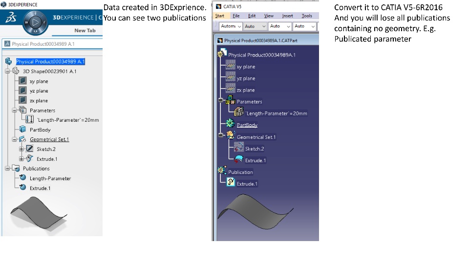

How to export a 19x 3DExperiece model to CATIA V5-6R2016 as result keeping all publications. An ...
How to export a 19x 3DExperiece model to CATIA V5-6R2016 as result keeping all publications. And not only these containing geometry.Acc. documentation only publications containing geometry are exported. And this is the problem I have actaully.
