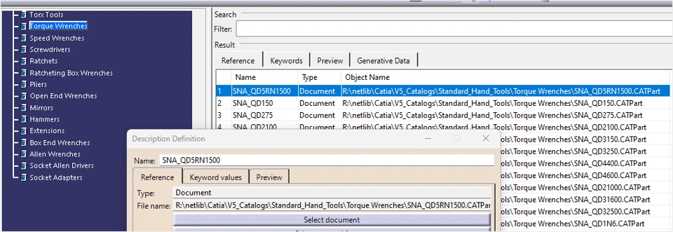

We are using Catia V5 R28 and R34. Our Catalog files and the corresponding catia files are stored on a network drive. Please refer to the image.
catalog
For all catalogs, we want to change the path of the CATIA files to a different network directory, E.g., V:\\Catia_Catalog. We can do it one by one using the 'Select document' command, but it will be monotonous and time-consuming. How can we do such an operation with minimal effort?
