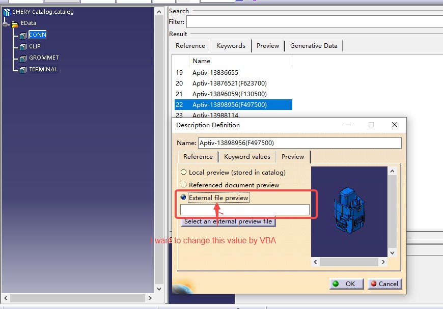

Hi! everyone,
I'm building a cataloag with a large number of documents, and now I meet 2 main problems. 1: When I change a catpart document and save or save as a new document, the new document will lost ico, just to be a blue pic. 2: This problem becomes the 1st problem, due to the pic is blue, I have to set icon pic for every document, so I'm guesting whether there is a easy way to do it by VBA. However, until now I haven't find yet. I tried reading "V5Automation.chm" and recoding my steps by recoding a micron but faild. Everytime I finish recoding a micron it ends to be an empty vba project.
