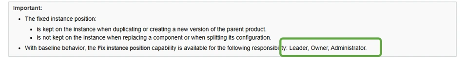

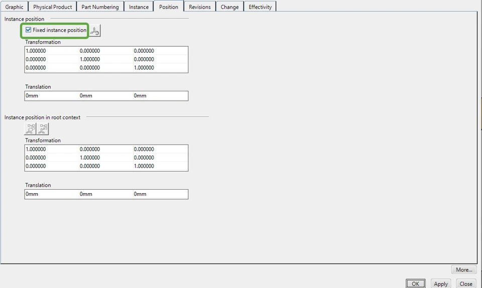

I was reviewing some of the several options for fixing components in an assembly and came across this option in the instance properties. It seems to have an advantage over an engineering connection as there is no way to move the instance so nothing can be out of date or require updating unlike an engineering connection. Unfortunately it looks like it requires at least the leader role. I can't figure out the reason for the restriction. Is there a setting that can be changed to give other roles access to this command?
