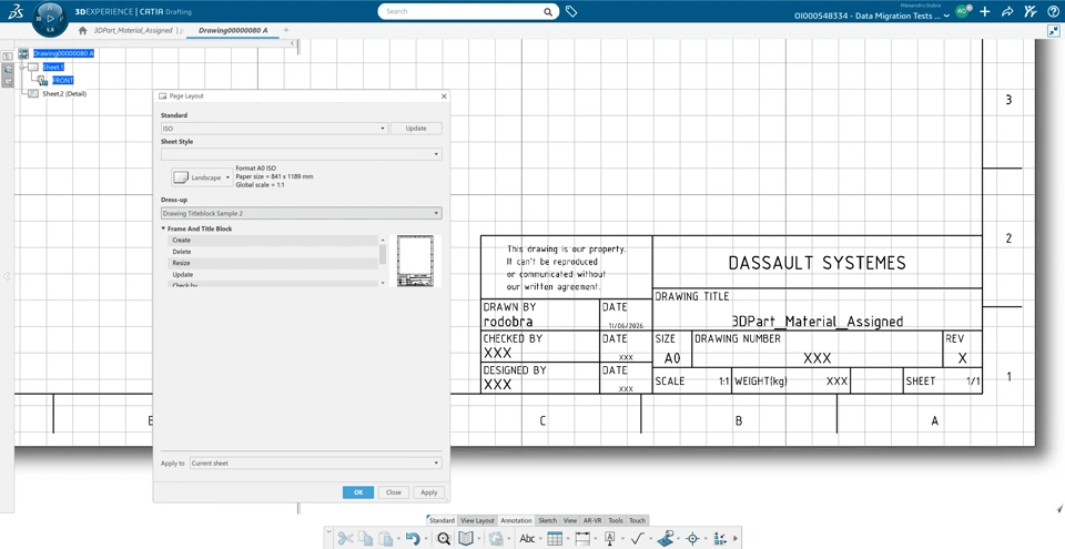

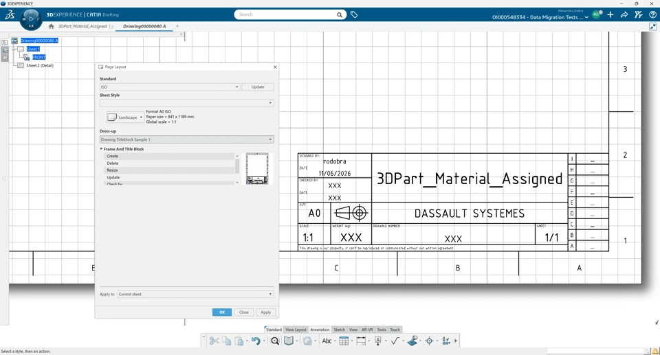

During evaluation, we've identified that none of the available OOTB Titleblock templates expose the Assigned Material to the 3D model.

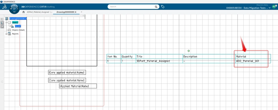

We've also identified that using the Text Template / Reroute Text Template, this option will not expose the Material info without clicking on the Assigned Material, directly from the Physical Product object.
In our point of view, this information should be exposed OOTB within the Titleblock templates, being part of the Part engineering definition.
The BOM Template Table (default) display the Material info OOTB.
