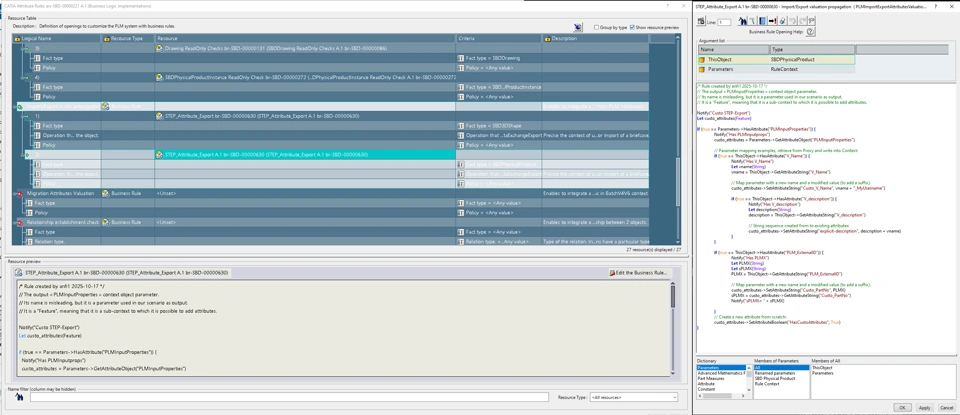

Hello!
I want to export our custom plm attributes with STEP export of PhysicalProducts and 3DShapes.
We are running a R2024xFD04 OnPremise installation and we have a "SubType" data modell configured with TXO (Specialize Data Model). thats why you see references to "SBDPhysicalProduct" and "SBD3DShape".
I have adjusted some data setup according to this article on User assistance
and
And the attached image.

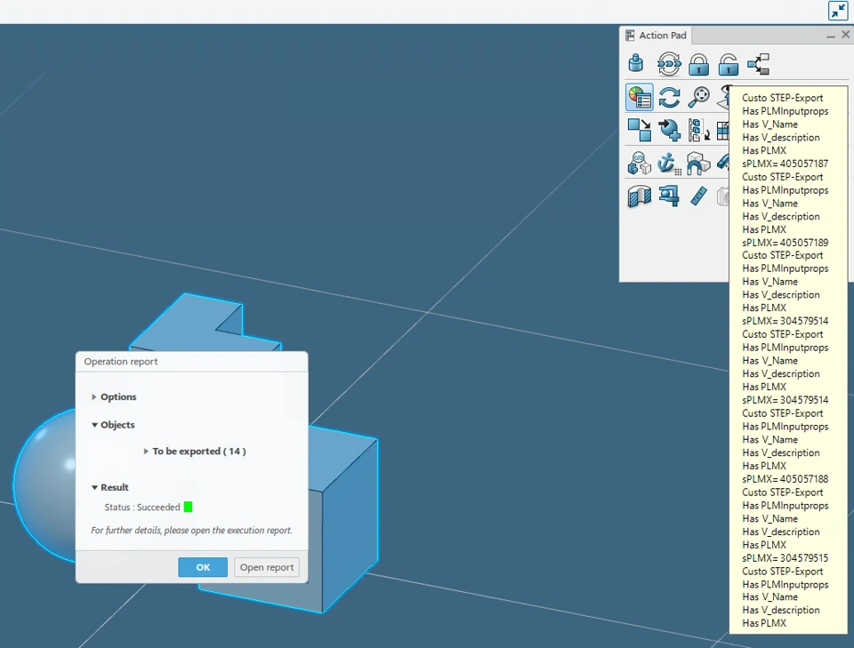

With all my current "Notifies" in the EKL-script i can validate that the script is triggered and seems to be running without error whenever a SBDPhysicalProduct is exported to STEP.
As referrence a STEP file has also been attached as a Codeblock 🙂
The expected result is to to have a line in the STEP file for each added custo-attribute according to my EKL-script.
And that would be a line for "Custo_V_Name" and "explicit-description" and also "Custo_PartNo" but i cant find anything 😟
