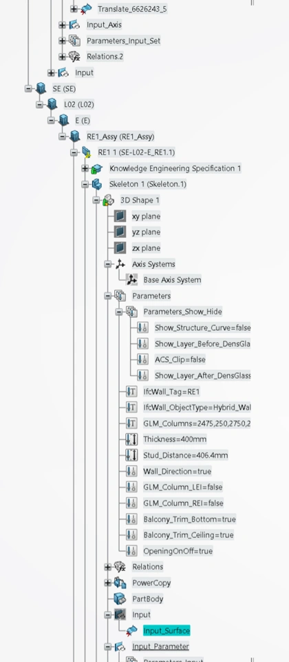

Engineering Template Input link bug.
After update R2025x Hotfix 0.14
Engineering Template Instantiate behavior changed:
They lost the external link after instantiating the Engineering Template from the script or manual.
I wonder if this happened only to me or if someone has the same problem.
My inputs are :
Surface that named "Input_Surface"
Some of Parameter as Value Pointer.
