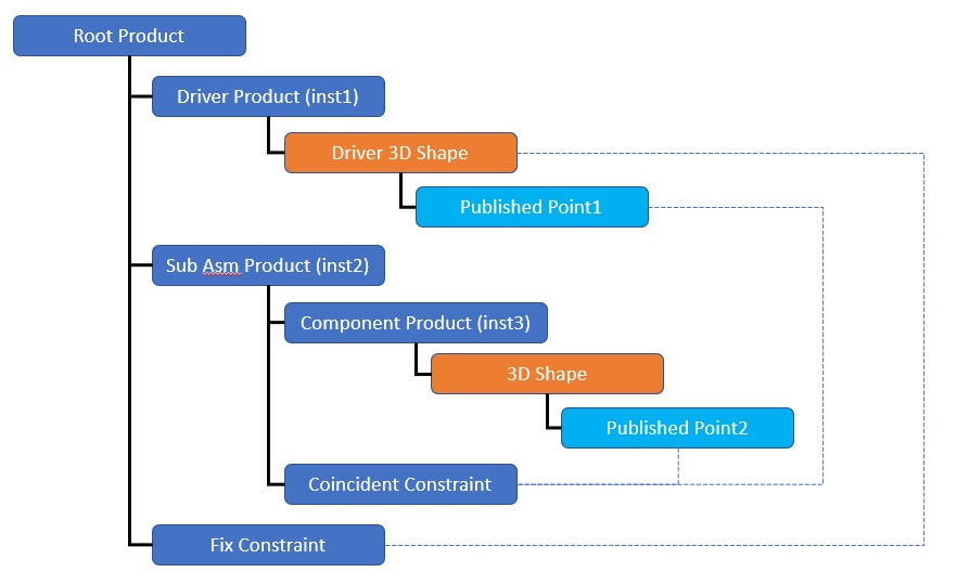

I have a Product as shown in the image below. Interactively I am able to constrain the parts as shown. But, when I create the connections using EKL, create constraint works from the Product root.
Example:
path1 = root->CreatePathString( inst1 , P1)
path2 = root->CreatePathString( inst1 , P2)
createdCoincidence = root->CreateConstraint("MyConstraint"+1 ,"Coincidence" ,path1 , path3 )
I want to specify Sub Asm Product as the reference.
path2 = SubAsm->CreatePathString( inst3 , P2)
createdCoincidence = SubAsm ->CreateConstraint("MyConstraint"+1 ,"Coincidence" ,path1 , path3 )
