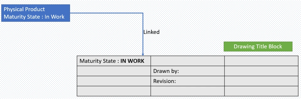

Step 1: Create a physical product and create a drawing
Step 2: Create a table in drawing and linked maturity state attribute
Step 3: Save 3D and drawing
Step 4: Promote the product to released state ( it brings related drawing and also it is promoted)
Step 5: Open Drawing in CATIA and notice that maturity state cell needs to be updated because related design is in Released State.
Step 6: Updated drawing needs to be saved but it is in released state:
Question: We want to update the maturity state cell according to the part. However, when the above process steps are applied, saving and editing problems occur on the released data.
Is there any best practice do you have?
