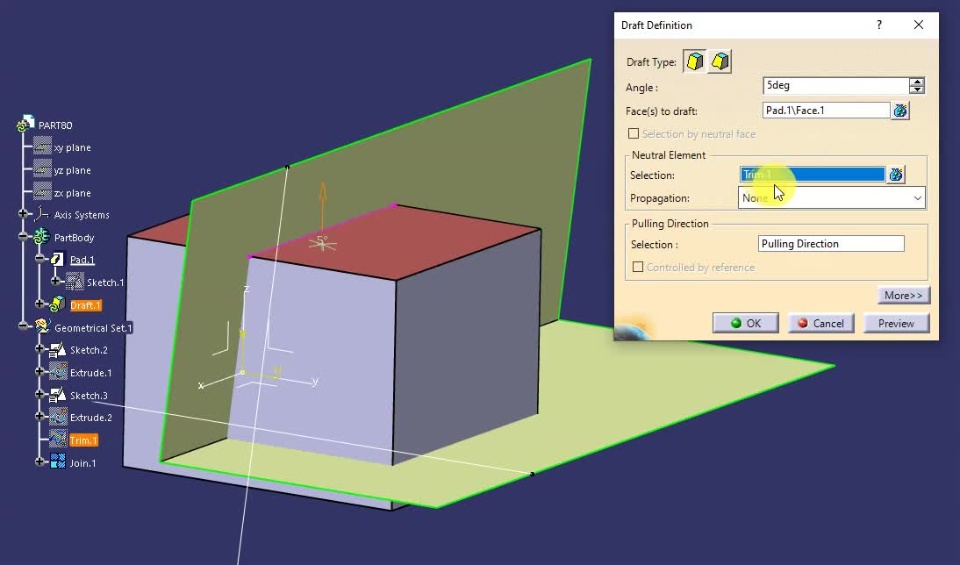

Hi Everyone,
somewhere between Catia v5 R2019 and R2020, I've noticed a change in behavior of a Draft feature when choosing a Neutral Element. When the element I want to choose is a surface created with 'Join' (single input only) or 'Invert Orientation' and I click on it from 3D viewer (not tree), Catia selects not that surface, but its parent instead, almost as if you had used 'Quick Select'. I am attaching video showing this behavior. Do you know if this is intentional, or a bug? Can I turn it off somehow?
I often use 'Invert orientation' or 'Join' instead of copying surface with link, because this gives me additional flexibility with a possibility to switch the surface normal vector. But when I am drafting some solid and want to chose the Joined surface from specific Geometrical Set, Catia chooses totally different surface from different location in the tree. It doesn't make much sense to me. I know that I can use 'Feature Element Filter to overcome this problem, but I'm wondering if that's something that should be reported to Dassault. I also didn't see this change mentioned in R2020 PEO (Product Enhancement Overview)
