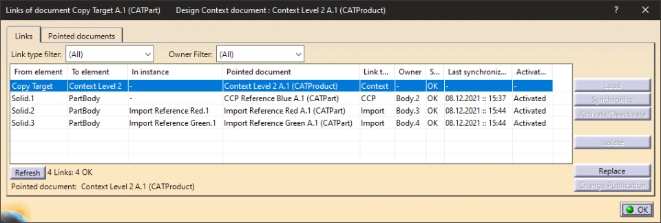

Question = When creating Links (Context/Import and CCP) in CATIA V5-6 and investigate in ENOVIA "Relations" Widget/App > where do I see the "Import" Links?

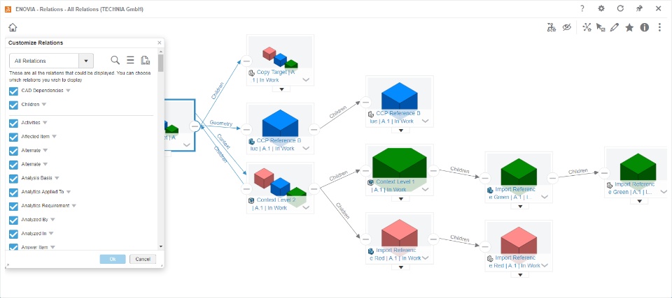

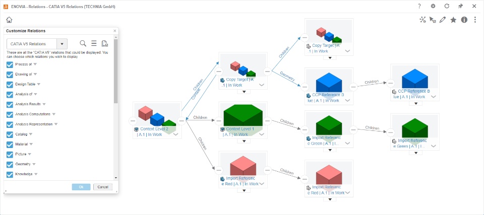

With "All Relations" and "CATIA V5 Relations" I just see the CCP-Link visualized and the Context-Link bit the Import-Links are missing.
