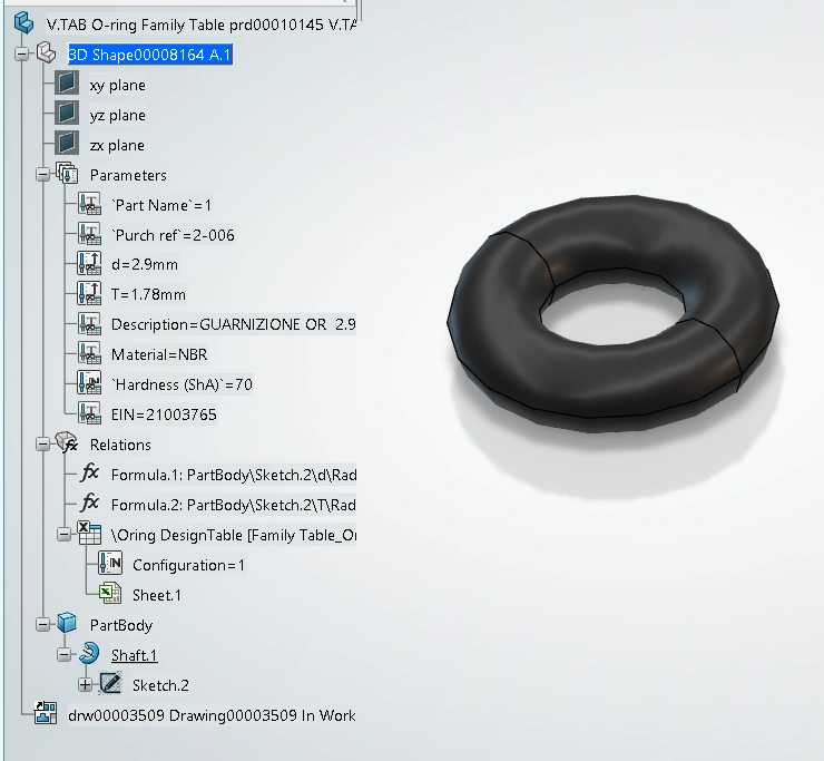

I create a family table master component (o-ring for this example), using relations and a design table.

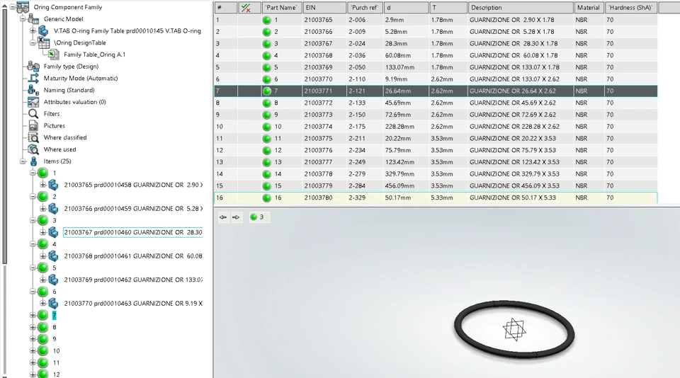

Then  with Component Family Definition I created all the component defined into the Design Table.

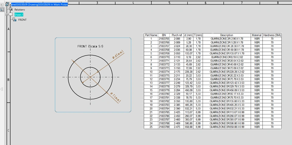

Now I want to create a drawing where I can include a list of all created component...the list must be or derived from the Design Table....this because I would like to mantain the link with the table.
I cannot find solutions.
The list created in this drawing sample is generated as "Insert Object" and it's not associative with the Design Table.
