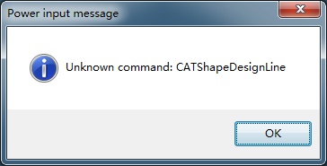

3. type c:CATShapeDesignLine in PowerInput, then press enter key. the LINE command panel shows normally.

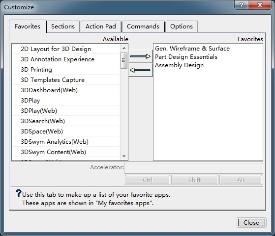

4. open Customize dialog, then just close it.5. type c:CATShapeDesignLine in PowerInput box again. this time, we get the err msgbox of "unknown command".
6. type c:CATShapeDesignLineHdr in PowerInput box, the LINE command panel shows again.
