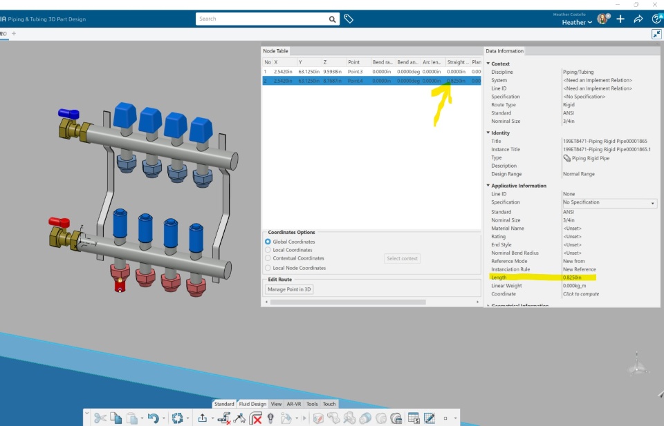

When creating a route in the Piping & Tubing 3D Part Design workbench, I assign ports and port attributes and then when I use those ports, the route tool creates a run with only 2 nodes and a default length of .8250". I have to go in and delete the end node to be able to extend the route. Does anyone know where this .8250" is driven from? I can't find any preferences that seem to set that length or allow me to leave it empty so I can make the run whatever length I want initially. (Please note, I am part of a small group of student learning how to use this workbench independently so we don't actually have a designated set of resource data sets to draw from. Everything I'm using is parts and equipment we've designed on the fly.) Thanks!
