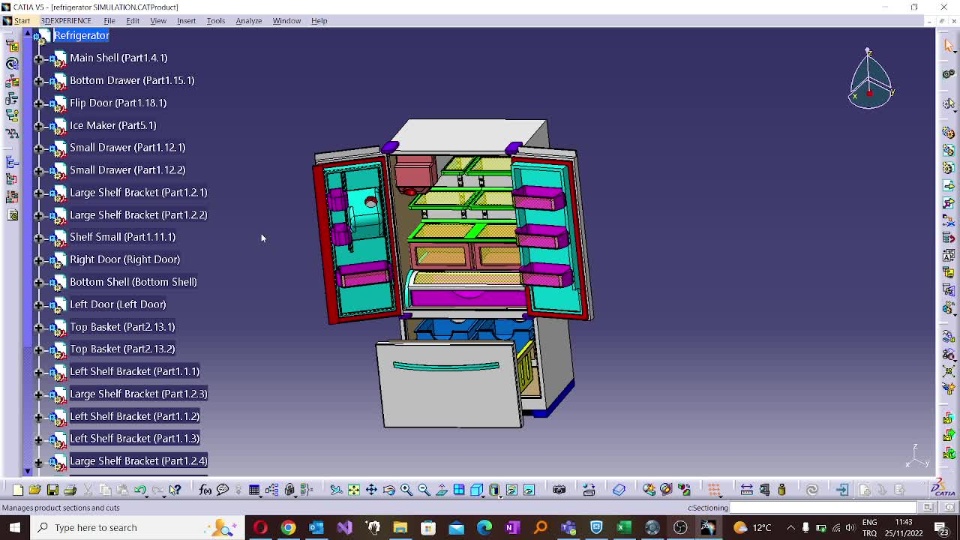

I'm trying to make an attribute macro in Catia V5
. As seen in the video, I can show the mass and material attributes in the BOM table. But I couldn't find a way to read the surface and some inertia values to the attributes. Does anyone know the code for these attributes I can't read?In my macro code, I read the mass like this.
