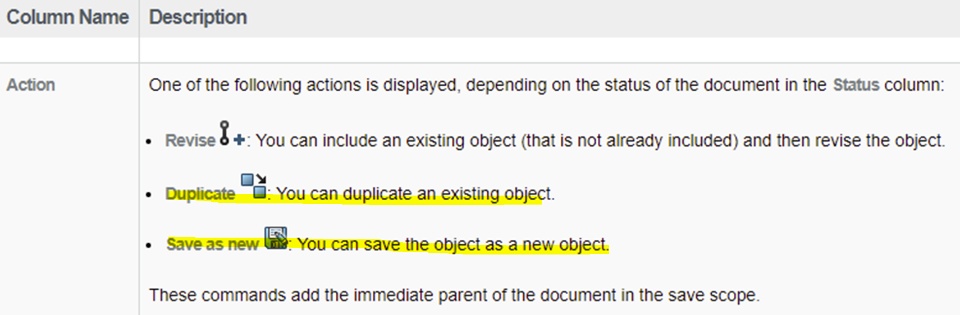

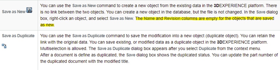

CATIA V5 Save option(UE5)
Duplicate : You can duplicate an existing object.
Save as new : You can save the object as a new object.
I don't know the difference between the two(Duplicate / Save as New).
What exactly is the difference?
Even after reading the help, I don't understand.
The two functions feel the same.
Help Link : https://help.3ds.com/2022x/english/dsdoc/CV5UserMap/cv5-c-SaveDialogBoxUPS.htm?contextscope=cloud&id=a9c05ee283db422b83d579537729e6d4
