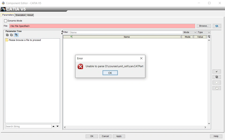

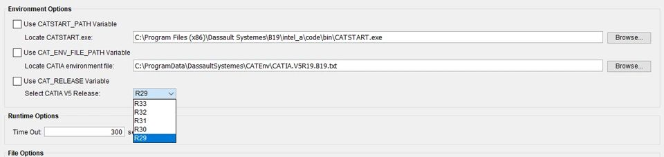

I have used Abaqus, SolidWorks and some other components with Isight 2024, but this is the first time I am trying to use CATIA V5 component. I have succesfully selected my CATSTART and environment file path. However my CATIA version is not listed as an option. So, I am getting the following error if a choose e.g. R29 alternatively. How can I achieve using CATIA V5 R19 with Isight 2024?
I have tried adding environmental variables. I can add variables like "CNEXTSPLASHSCREEN=YES" but I could not find a way to describe my CAT_RELEASE as a proper variable.
