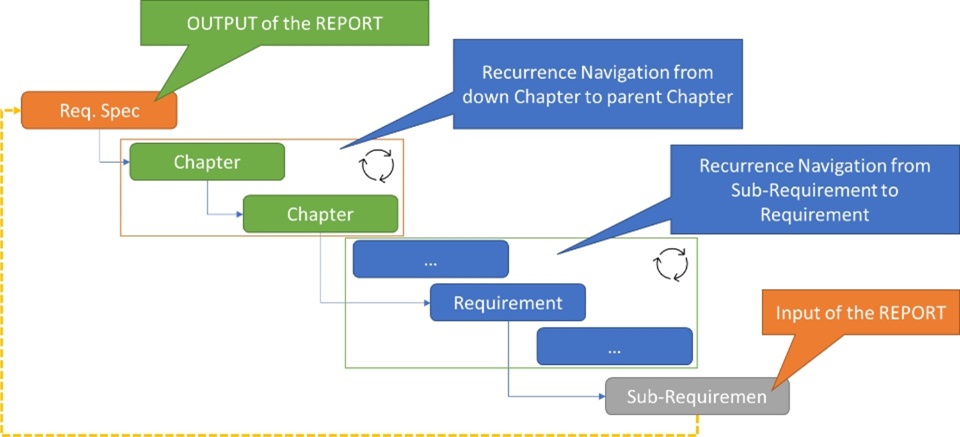

I would like to create a Report that is using as INPUT a sub-Requirement and return the where-used Req. Specification.
(like in the picture)
The report should work regardless of the numbers and object types within the structure between the sub-Req. and Req. Spec.
Do someone have any suggestion?
Can this request be done using OTScripts?

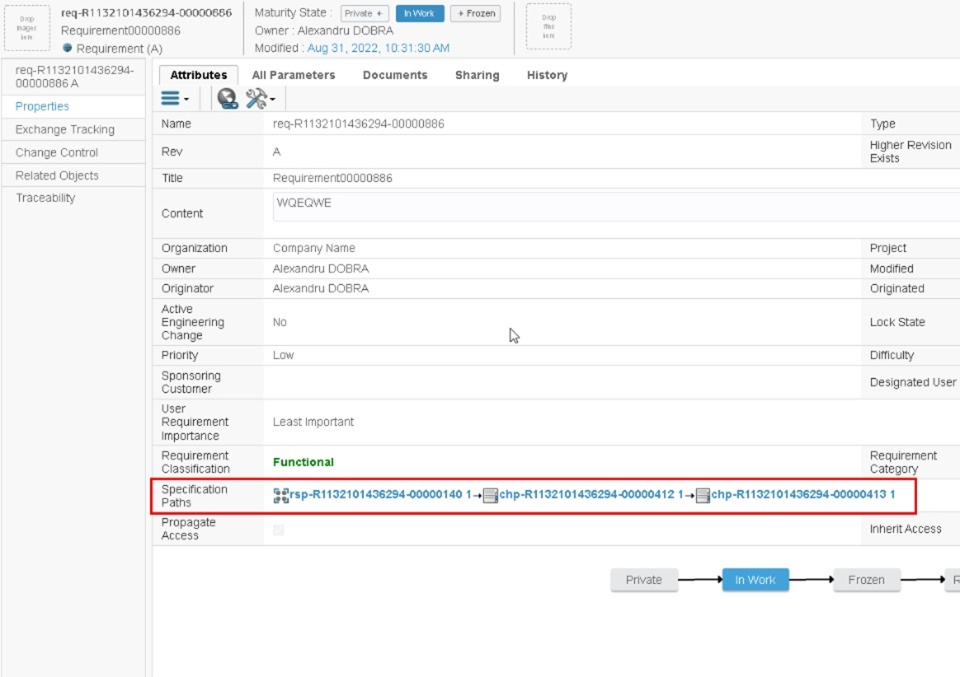

EDIT:
After some more research in the 3DSpace, I notice that this info is already available in the Requirement Properties form. --> Specification Path.
Exactly this information I do need to retrieve in my report. The first element from the Specification Path List.
