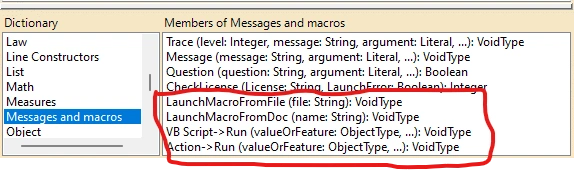

Obviously a macro cannot be ran continuously on a loop in the background so I have tried to find a way to use a reaction to run the macro. Below I have a screenshot of some functions provided in the reaction editor which may allow the reaction to call and run the macro. However, I have tried using each of these inputting various formats to locate the macro from file explorer by copying the path and name of the vbaproject to naming the specific script within the project file. I am yet to find a working solution, with my reaction code being able to be applied, therefore I know there are no errors within any aspects of the code, but when executed I recieve errors saying the file or document cannot be located. I have quadruple checked that the file path is correct.
Can anyone provide me a solution to run a macro from a reaction?
