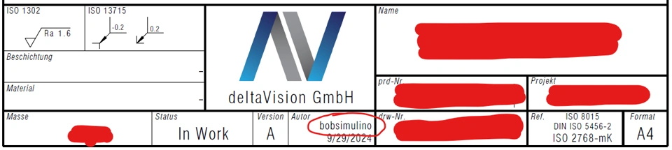

Hello,
We started using the automated title blocks in our drawing templates (3DEXPERIENCE on cloud, release 24x).
When creating it, we want to show the author of the drawing. For that, we use the attribute "Owner" of the drawing.
When we do so, what is shown is the username of the user (here "bobsimulino", it would be the trigram for a DS employee) that the user chose when connecting first to the platform, but not the First Name - Last Name. Some users have chosen random usernames by connecting for the first time, hence their usernames can't be used in a drawing, and we can't change the usernames after creating the account.
Is there another a possibility to see the First Name - Last Name in that field?
