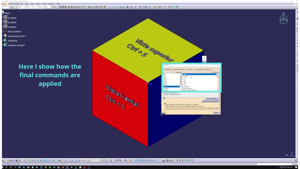

Hello CATIA users, a few weeks ago I saw a video of the great @MT where he used commands to be able to position your piece in the view you want (Front, Right, Top). As a SolidWorks and CATIA user it was difficult for me to use only the view bar instead of commands like in solidworks.
That’s why I bring a video of how to enter these commands inside CATIA. Thank you very much @MT i for giving the solution of a problem to all users of these softwares.
