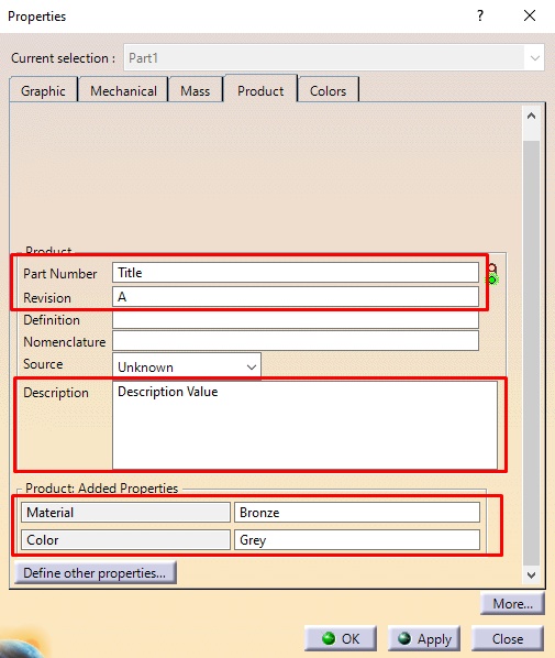

I found a macro to add text to a view from the Coe platform. However, I can only add View name and Scale properties to text in the macro. I want to add different properties as a new line is that possible?
For example, I need to add values in part properties. Information such as Part Number, Revision, Material or user Properties. The picture contains information I want to add.
Can I add a linked attribute using MyDrawingView.Texts.Add?

Set MyText = MyDrawingView.Texts.Add(vbCrLf + "Scale", TextLocation(0), TextLocation(1))
Dim ParameterName As String
ParameterName = "Drawing" + MyDrawingSheet.Name + "" + MyDrawingView.Name + "\\Name"
Call MyDrawingView.InsertViewScale(1 + Len(MyText.Text), MyText)
Call MyText.InsertVariable(1, 0, MyDrawingDoc.Parameters.GetItem(ParameterName))
