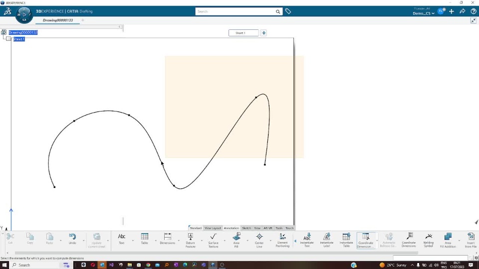

How to add a digit to Coordinate Dimension Table in drawing? The scenario I prepared for this is as in the following script;
- Opening the Drawing Screen in 3D Experience CATIA.
- Creating splines in Sketch tab.
- Running the Coordinate Dimension Table command in the Annotation tab.
- Select points on the spline and create the table.
- The number of digits after the comma of the dots in the created table appears as 2.
How can I add a value after the comma to the point coordinates field in the Cooridnate dimension table?

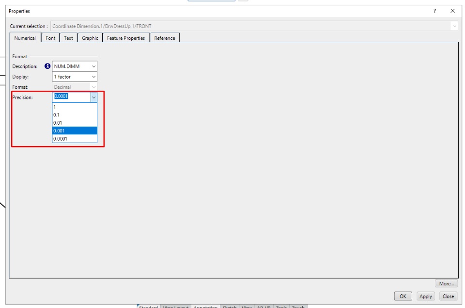

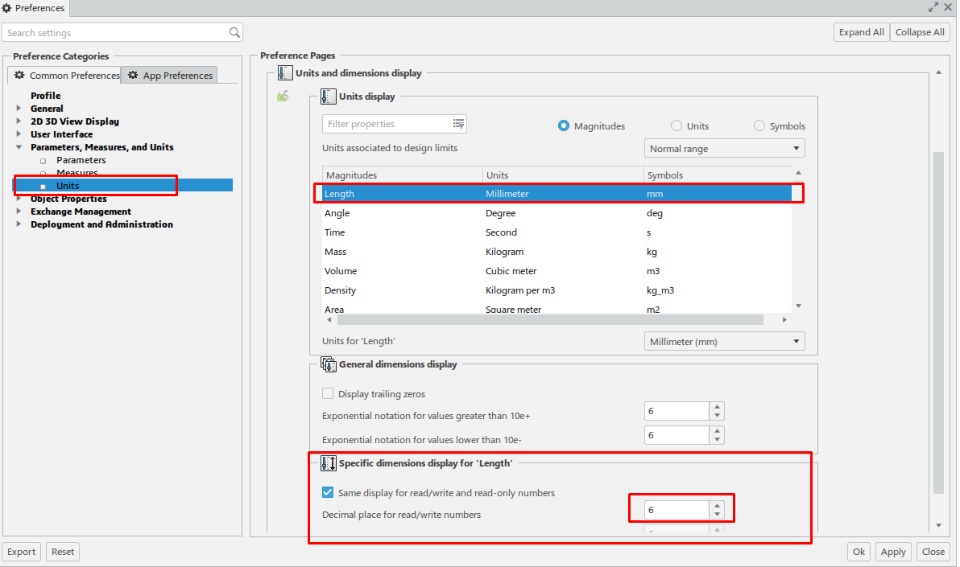

Actually, I found a few features, but none of them affected this table. I have also added the solutions I found as a picture.
Anyone have any information on the subject?
