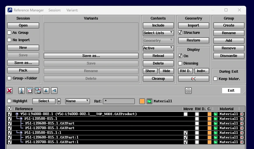

Hi, since a couple of versions it is possible to import CATProducts into he Reference Manager while maintaining their Structure. Which is super cool by the way!
Unfortunately it just works when drag and dropping the files into the modeling area and go through the Import File Dialog. When doing so it show the following choices:
Choosing "RefMan-Include" is basically the old behaviour. It gets imported but without any structure.
Choosing "RefMan-Open" imports the file including its structure into the Reference Manager. Which is awesome!
The issue is, when drag and dropping a CATProduct directly into the Reference Manager area (instead of the modeling area), I don't get to choose. ICEM Surf just assumes the "RefMan-Include" as default behaviour and drops in the data without any structure.
Is there any way to fix this? It would be a shame when such a cool feature would not utilized to its full potential.
