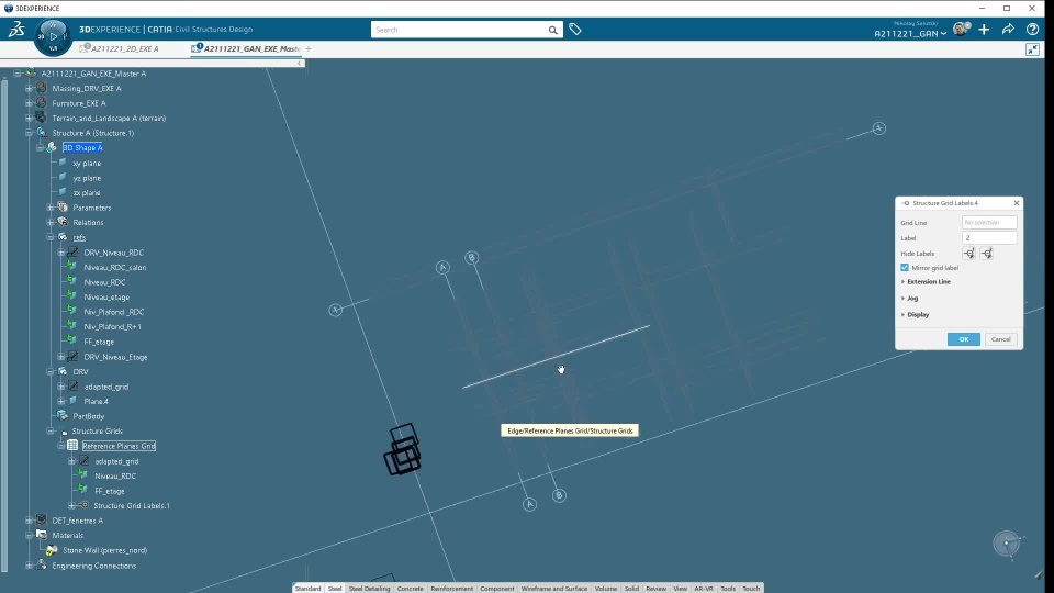

struggling with architectural grids and automatic annotations!
Came up against another hurdle trying to create and generate architectural grids in my drawings. There seems to be an issue with the annotations. First they get generated somehow flipped in the 3D space and then in 2D all of them are shifted (See attached video.). I have been wracking my brain for 2 days with thit issue and could really do with some help . I could not figure out as well what controls the colour of the grid lines and related annotations in the drawings.
May be am totally missing the concept of smart view generations. Could mixing standard views and sections be not compatible with the "smart views". I realise that my workflow is far from ideal, as I have been building my model using only standard features and slowly trying to implement many of the architectural elements and aids available in the "Building Design Engineer" role. I went trough all the videos that sort of cover that aspect of the program and all seems so beautifully executed on the fly but could not find a lot of clear guides as to how to implement in practice (really struggling in fact). I would appreciated any guidance in that regard!
