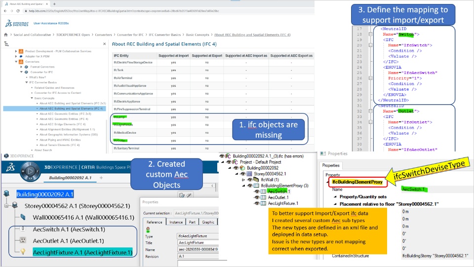

Mapping IFC Objects to Aec Objects
Looking for a best practice document to define the mapping of IFC to Aec Objects when Importing and Export data.
I have created several custom sub types under AecOtherArchitecturalElement and AecOtherStructuralElement. The intent is to map IFC objects during Import and Export of OOTB and custom Aec Types.
I have found the documentation on this topic and have modified the AECDataExchange.xml and uploaded with data setup, but it is not work. Thanks in advance.
help doc reference:
Installation and Setup -> Customize -> 3DEXPERIENCE Platform -> Behavior -> Data Setup -> List of Resource Set IDs -> 3D Modeling -> Building & Civil Data Exchange Resources
help doc reference​​​​​​​
This might help explain the process I followed a bit better.
