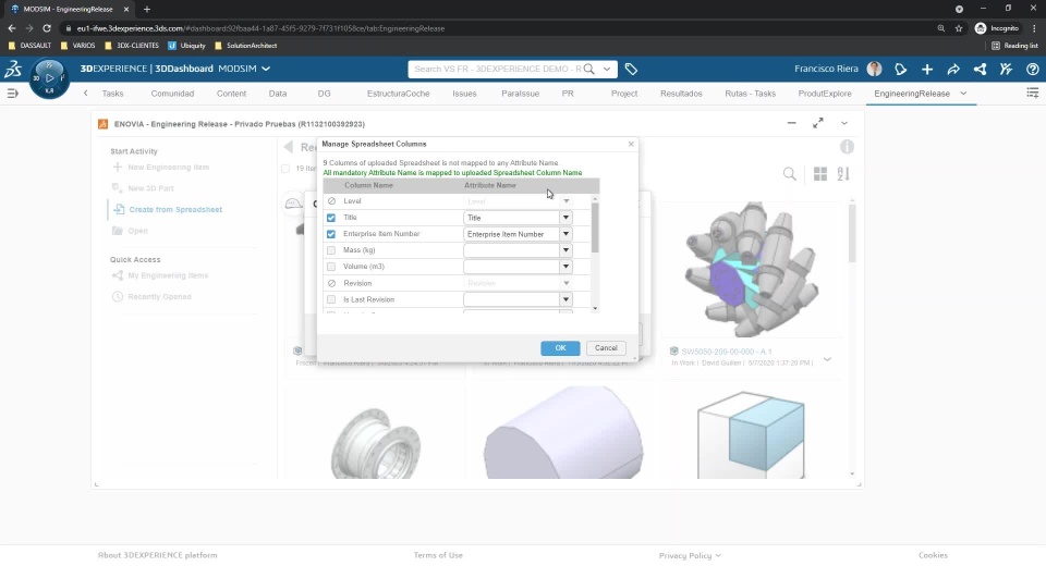

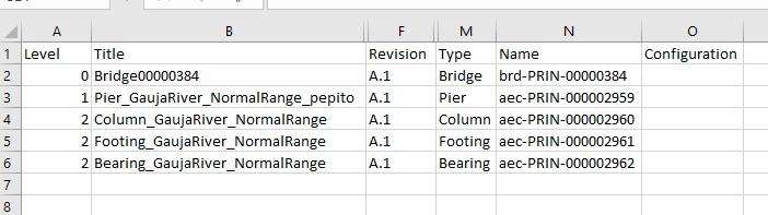

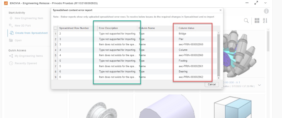

Hi, we have tried to import a product structure (from a .csv file) by means of Engineering Release widget (XEN-OC) but we receive an error message saying that "Type not supported for importing". The thing is that there is no references explaining that CCT objects are not supported by XEN. Could you please confirm if it is the case? Attached: video reproducing it, an image with error message and a snapshot with content of csv file used.
