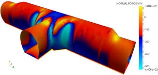

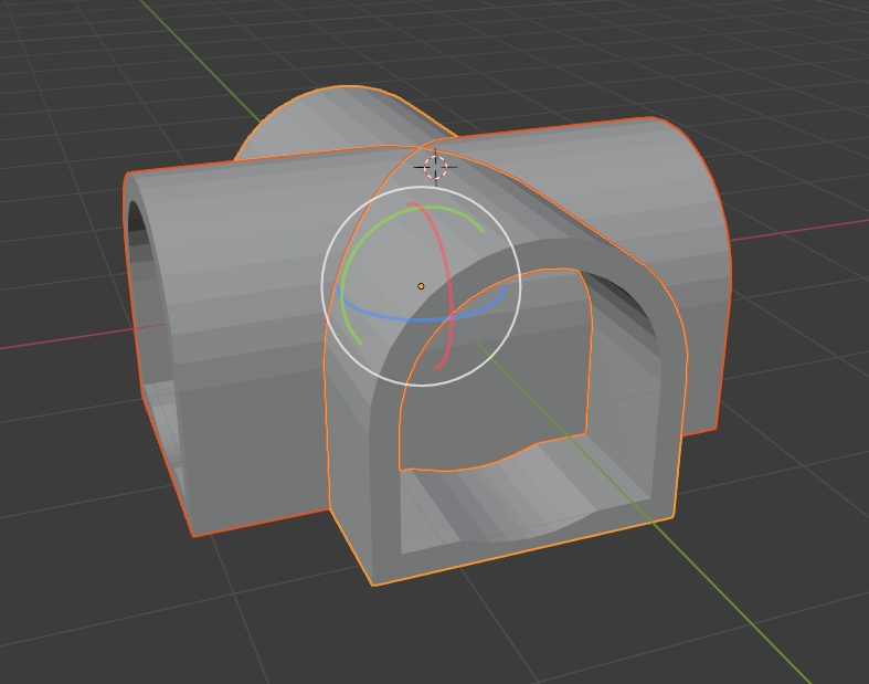

Intersection of a tunnel running section with another , smaller tunnel's running section.The intersection of two tunnels implies that the interconnection requires a specific design.
Intersection between two tunnel running sections with similar dimensions. this is a use case that is similar to the above, but with specific issues which necessitate particular phasing in the works

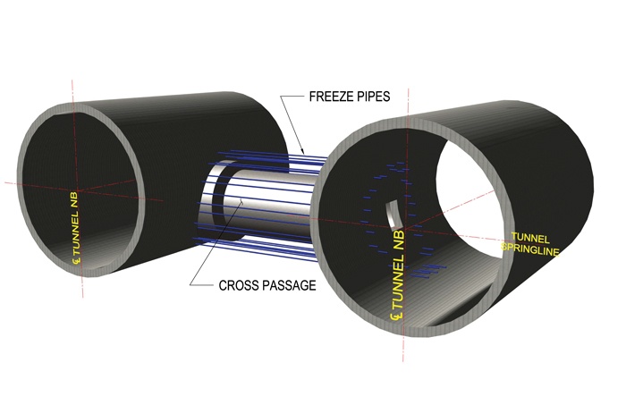

Cross-passages is a special case of the connection component as, within a single component, two connection are modeled as well as the full length of the interconnecting tunnel. This is usually done when the two main tunnels are not too distant from one another. Can also be used between a tunnel and a shaft where the connection with tunnel and shaft as well as the cross-passage are modeled as a single entity.
This component avoids using two interconnection components plus a typical section for the running section of the gallery when linking the two main tunnels/shafts in close proximity. This is important as the gallery's design is impacted by the tunnel and connection details (rock decompression, etc..). If the distance between main tunnels is important then it is better to model the gallery seperately from the main tunnel connections, as would be done when doing a 3D FEM model.

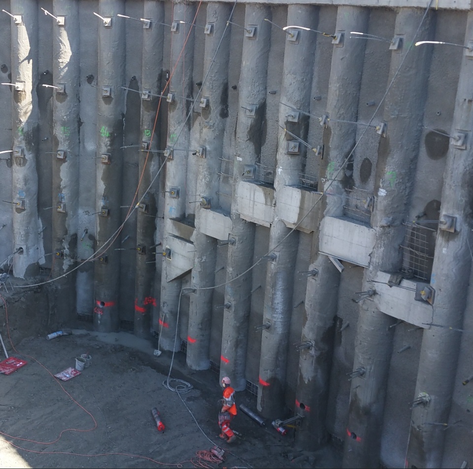

Excavation, inclusive of overbreak, used to calculate spoil volumes and to drive the phasing of the excavation works
Ground support (planar) such as shotcrete or injections in the case of ring segments. Rock bolts, steel sets, etc.. have their own components
