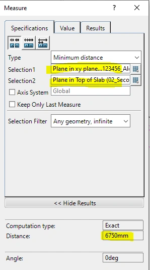

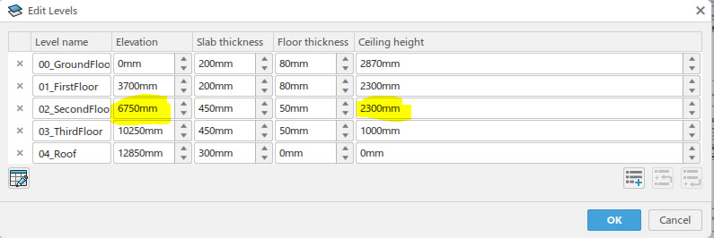

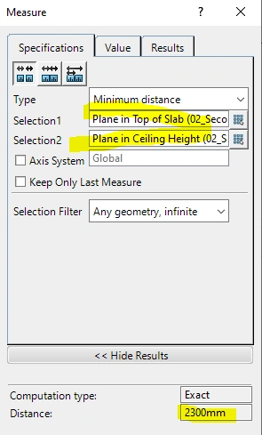

Recently I have been playing with the "Levels" command in the Building 3D Design application.
Generally I believe this is a very useful tool. I did notice however that both the "Elevation" and the "Ceiling Height" are being calculated from the "Top of Slab" plane.
For us it seems more logical that these values are calculated from the "Finished Floor" plane.
I do understand that this might be different depending on what stage in the construction project you are working on. But for us as a facade builder the finished floor level is generally more relevant.
Obviously there are ways to work around this, both manually and automated, but perhaps it could be an option to allow the user to choose which level you wish to use as the driving plane/value.
