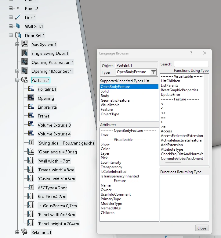

Why the UDF that is created inside a door with an Object Type is not recognized as a UserFeature ?
Indeed, I search to know from EKL the Object Type of a door or window to classify it ?
Or maybe I could find it from BIM attributes. But I don't find the good attribute to read.
Thanks in advance
