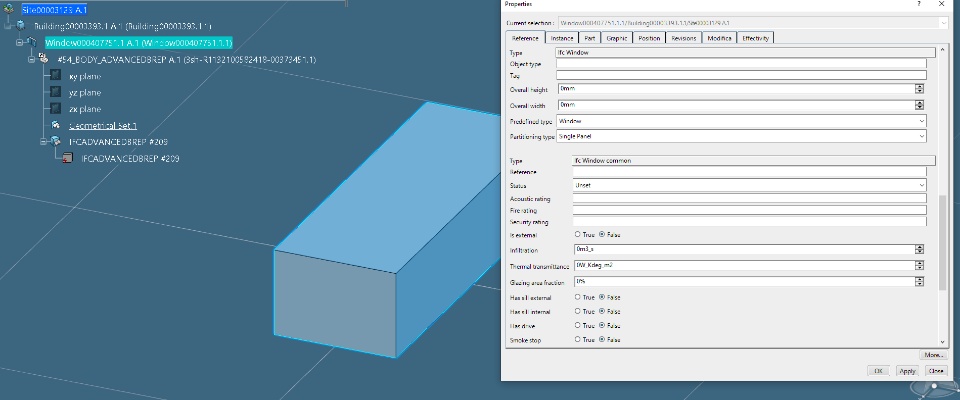

I would like to know if it is possible to import into 3dexp an IFC file containing objects with their own custom parameters and see them in the properties.

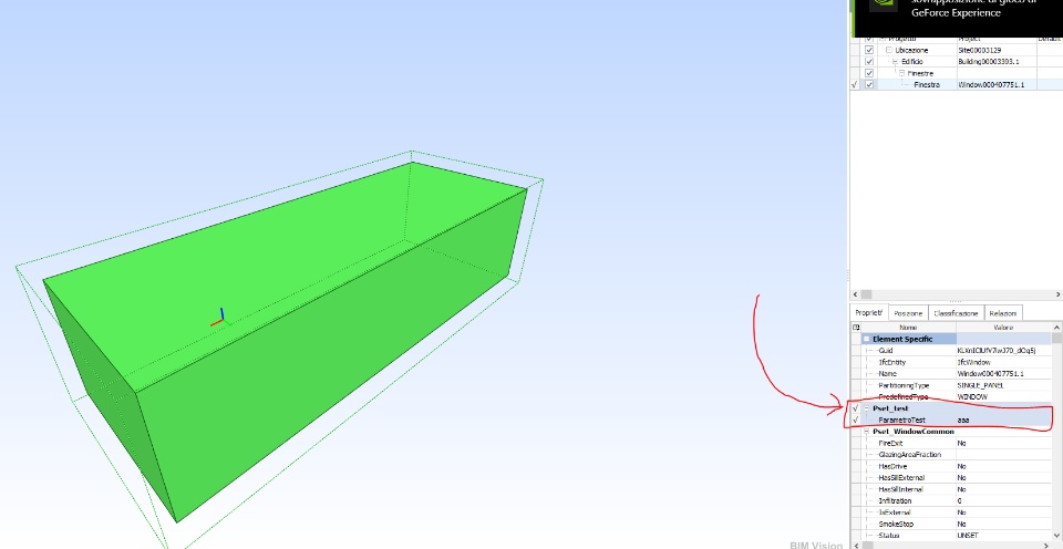

At the moment I've tried to import a very easy ifc file customized with a parameter set containing a custom parameter (see first image)
Once imported I can see standard parameters but NOT the one that I've created (see second image)
Is there a way to manage this type of settings during import?
