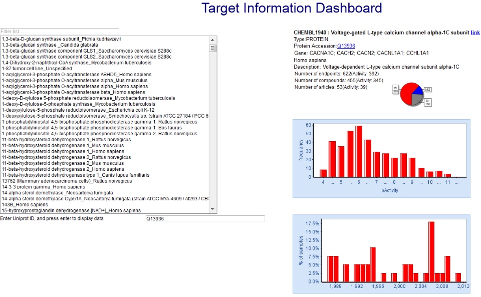

I used the Stock Dashboard as template: a list of all targets in ChEMBL can be filtered to select target of interest. By clicking on one target it will automatically populate dynamic containers to show description, activity, and popularity (number of paper/year) for the specific target.
Also as there is a webservice to go from UNIPROT ID to chembl_ID, I added the possibility to manually enter a UNIPROT ID (below the list), and pressing enter will show the data (when in the box).
A small description with link to ChEMBL and unitprot + a pie chart to show the repartition of activity for the target: active, inactive compounds, and compounds with other endpoints (not Ki, IC50, EC50).
A graph with pActivity bins
Number of articles per year

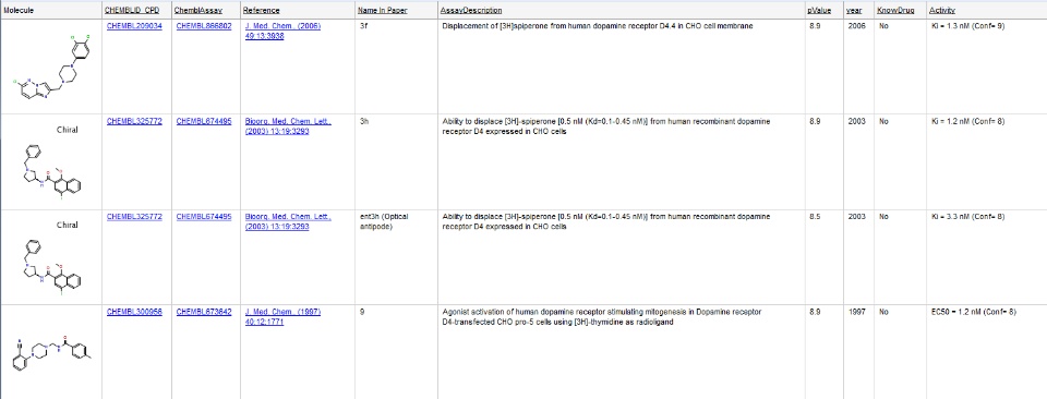

But there is something more: it is possible to show compounds for a specific activity bin: click on pActivity bin will get compounds from that bin and show structures, activity, links to the compound on ChEMBL, the assay and the article (via Pubmed).
(It would be possible to show all compounds, but as the data has to be retrieved compound per compound it could be very slow for some targets, and ChEMBL website may be more appropriate).
