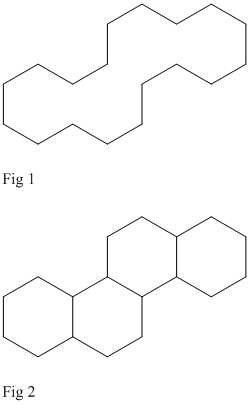

I have generated some structures (macrolides) and now I have their SMARTS string for e.g.
I have a 18-ring macrolide (Fig 1)
Whose SMARTS is
[#6]-1-[#6]-[#6]-[#6]-[#6]-[#6]-[#6]-[#6]-[#6]-[#6]-[#6]-[#6]-[#6]-[#6]-[#6]-[#6]-[#6]-[#6]-1
And corresponding SMILES is
C1CCCCCCCCCCCCCCCCC1
Now I am using this to do a substructure search on my another database and pulling out all the molecules with this matching SMARTS string.
Its working fine but along with the matching 18-ring macrolides I am also pulling out some structures that are like this (Fig 2):
(with SMARTS:
[#6]-1-[#6]-2-[#6](-[#6]-[#6]-[#6]-1)-[#6]-[#6]-[#6]-3-[#6]-2-[#6]-[#6]-[#6]-4-[#6]-3-[#6]-[#6]-[#6]-[#6]-4
(with SMILES:
C1C2C(CCC1)CCC3C2CCC4C3CCCC4
This is something that I do not want. ANy suggestion in how can I modify the searched SMARTS so that I keep such molecules out?
